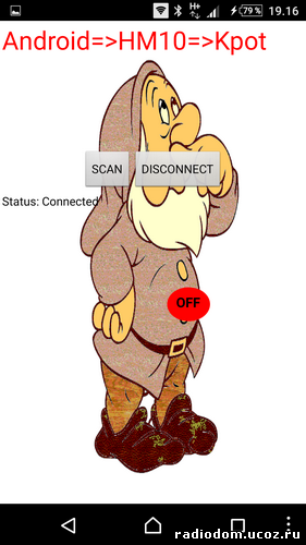

Andrew, I can send You the working connection version "Build.aiaa", so You just Import and build the final product..
Code is sent by email.
de-si-gn, Please send me privat message, so I can click on "Reply" ... I don't know how to send PM.. Cannot translate or open message page in  Bing translator....
Is it possible to send attachments in Privat Mail ????

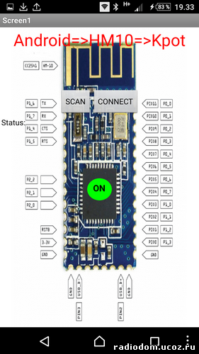

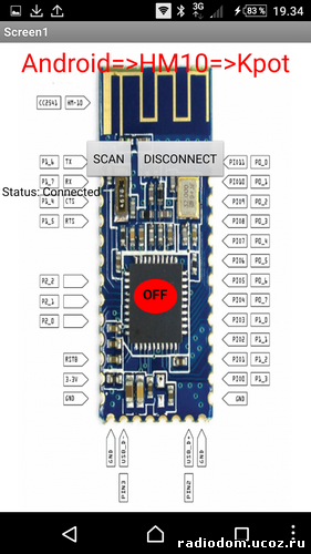

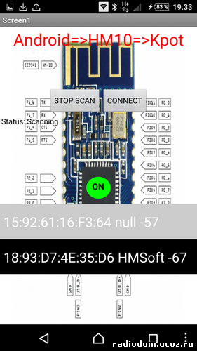

Usage of test app: Download unzip, install .apk .. App connects to both HM10 and HM11 modules, even "Bad" modules, which are not able to be paired with Android...! Module Must Not! be paired with phone.. If it is, then unpair first....
Connect Module with KPOT
Start Test.app click "Scan" button...
Select module name or address HMSoft from list.
Click "Connect"... Connection makes..
Status change to Connected.
Test connection with KPOT by clicking ON/OFF button and watch LCD.
Backligth on or goes off...
Everything is in order.
Click "Disconnect" !!!
And report how goes..

In HM10 module, AT+MODE2  AT+TYPE0  those are perhaps most important... HM11 connected directly out of the box. With the HM10 I had fiddled for several days before.... Including re-flashed with latest .V604 firmware..
