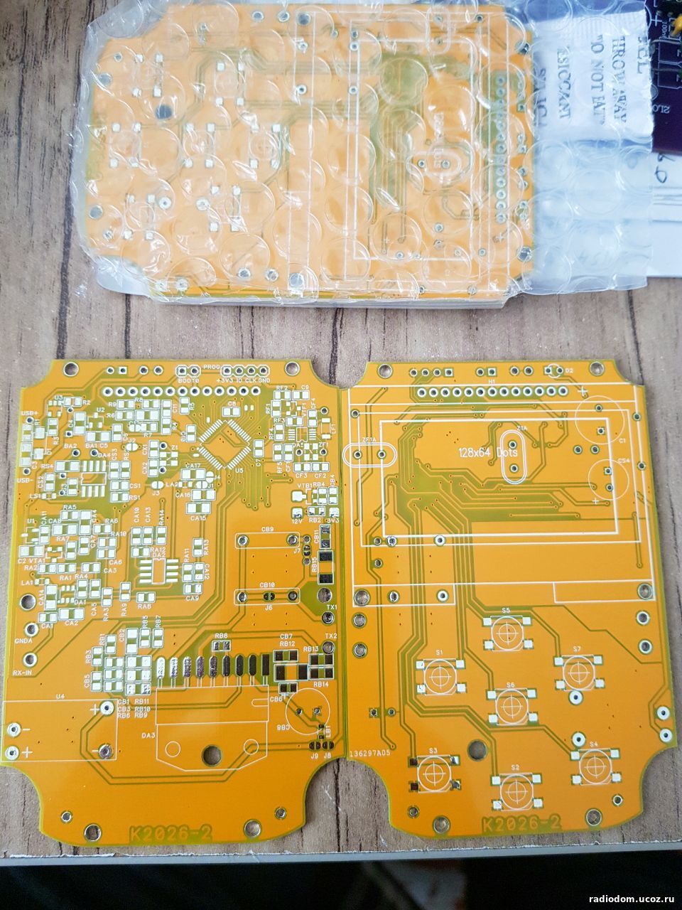

Andrew,The board has arrived. I’ve also ordered the parts.
Добавлено (23.09.2026, 14:51)
Hi Mr. Andrew,
What is the value of capacitors CB9 and CB10 for frequencies 8 and 24?
For making a 30*40 loop, what are the specifications of the coils (for frequencies 8 and 24)? I would appreciate it if you could guide me.
