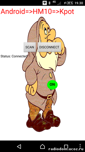

Andrew,  Hi.... Now we are getting there !!!
"nonametdy, Я использовал http://www.radiodom.org/forum/7-109-25092-16-1517816607 Кнопка "ON" "OFF" работает?""
Yes I know !! You use it... I left an "marker" and found the same in http://www.radiodom.org/KPOT_BLE_10.apk !!
The Answer is .. NO,, "Кнопка "ON" "OFF" работает?"",,,,,, There is NO buttons !!!!! Beacause YOU was criticizing the COMPLETE code I first send You.. That's why I stripped down the code, so there is ONLY the connecting part !!!!
You understand !!
Now we can go further and build the rest.. With buttons etc. etc..
Agree to that ????
If so, then I upload next part, where is reading buttons also...

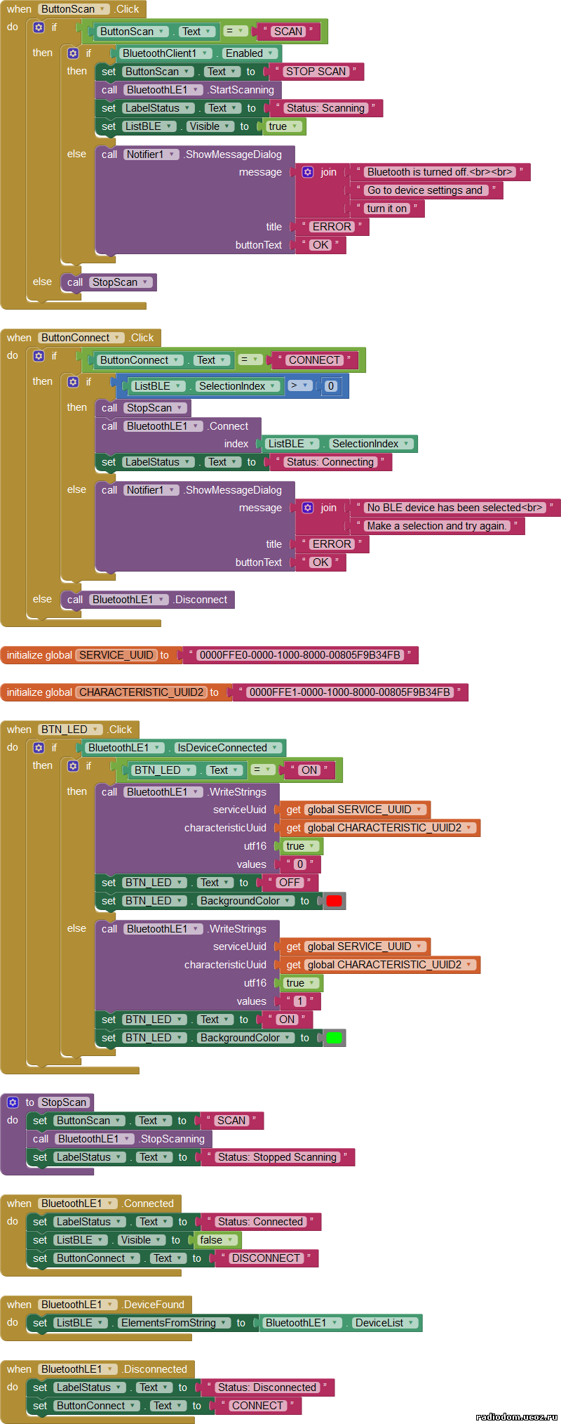

OK! Here we go...Here is blocks, with led on/off toggle button..... Just rearrange, as you wish, upload for us to test... Next add more code and functions - again upload for test..
When up and running... Then start improving.. By adding Timers for : Keep display "ConstantOn".... Timer for LinkUp (connection alive) checking 30sec/ intervals.. etc. etc.
Прикрепления: 3791069.png (108.0 Kb) · 3956611.png (217.7 Kb)

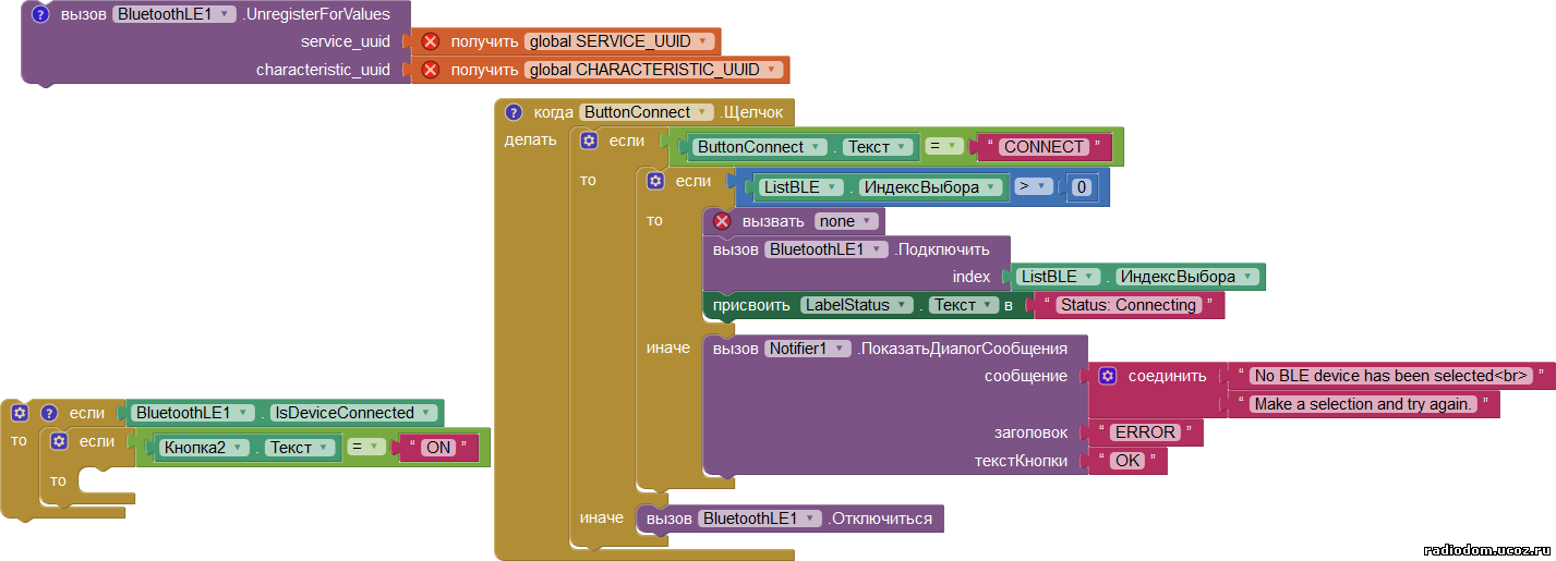

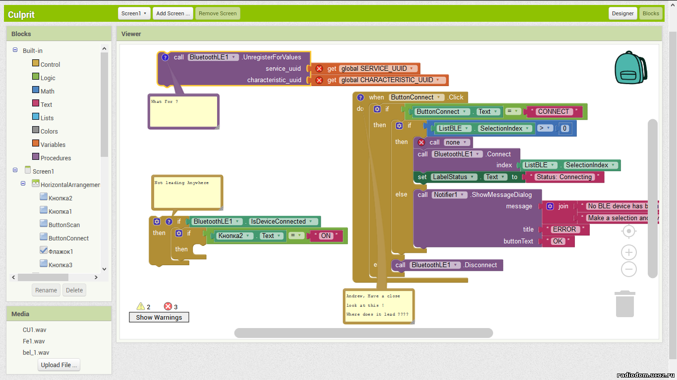

-OK,,, I see the culprit. Connection makes full stop, in "Dead end"..
It connects to HM10, then follow bad statement, connection drops, Leaving HM10 in connected state, but android NOT.
Open up dialog, with HM10 is not declared.. There is "Orphan" statement, not leading anywhere..
Cool..
I'll try to get a picture of it... One picture says more than thousand words... + Picture is multilingual..
Сообщение отредактировал nonametdy - Воскресенье, 11.02.2018, 11:42
nonametdyДата: Воскресенье, 11.02.2018, 12:36 | Сообщение # 477
Сообщений: 105
Here is pictures. Look at the comments in the English version... Added also in Russian language..
if BluetoothLE1 . IsDeviceConnected
then !!!!!!!!!!!!!!!!!!!!!!!!!!!!!
Прикрепления: 7700434.png (78.4 Kb) · 6992159.png (235.7 Kb)
