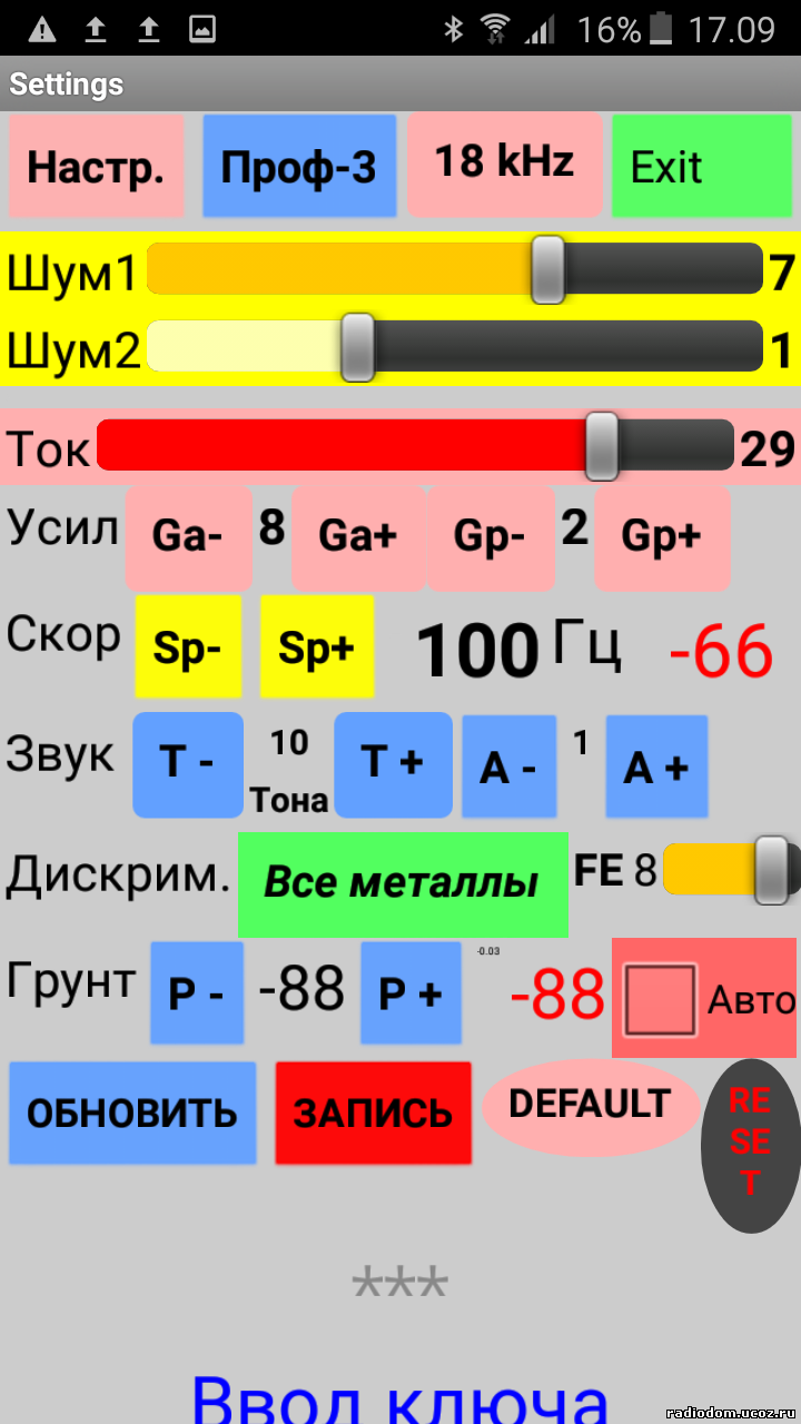

Цитата acikaa87 --Zenit--, where to see coil balance??
On the page where you set the frequency

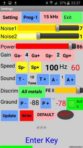

--Zenit--, its on zero, when i move al can on coil ti goes fro 10 to 60mv
--Zenit--Дата: Понедельник, 04.11.2019, 17:23 | Сообщение # 1758
Mole Smart earned from you or is it still only responding to the bank?
Take screenshots with your settings

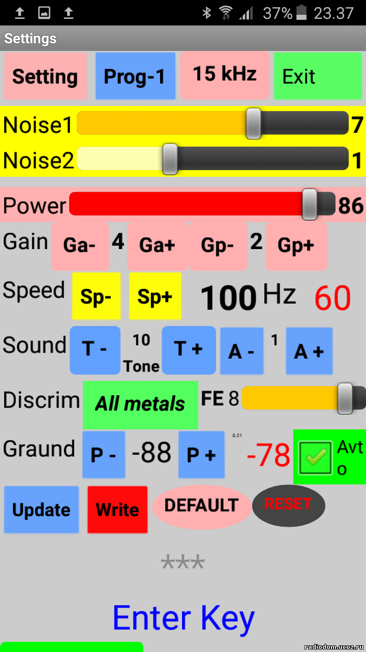

acikaa87xДата: Понедельник, 04.11.2019, 18:12 | Сообщение # 1759
Сообщений: 128
--Zenit--,now can detect coin of 0.5e on 20cm
Прикрепления: 8074813.png (172.8 Kb) · 7943032.png (208.0 Kb)

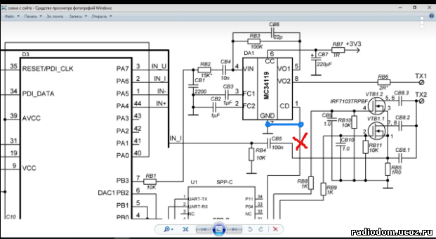

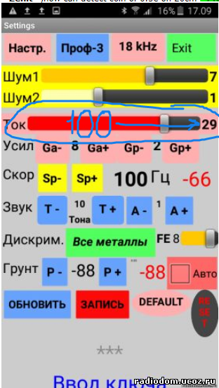

You have a current of 29 mA in the coil. When you make 100 mA there will be 50 cm.

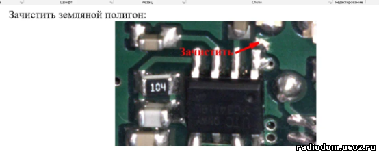

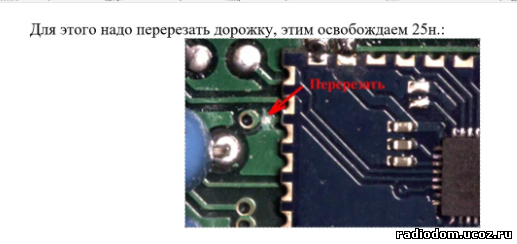

You incorrectly modified the board 5.1
Прикрепления: 2628530.png (94.5 Kb)
--Zenit--Дата: Понедельник, 04.11.2019, 18:47 | Сообщение # 1761

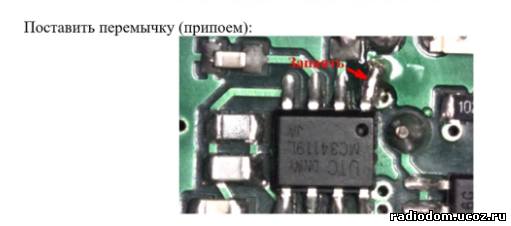

cut
clean from varnish
to connect
Прикрепления: 0486224.png (130.6 Kb) · 5323927.png (111.3 Kb) · 2215517.png (117.3 Kb)

--Zenit--,i compared schematic from v4 and v5, and do everything according to differences from v5. on da1 lifted up pin1 and connected to pin7, cuted trace from rf1 and connected to atx 25pin,cutted trase on atx 6pin added ra11-ca7-ca8 and connected them acording to schematic,and added r8

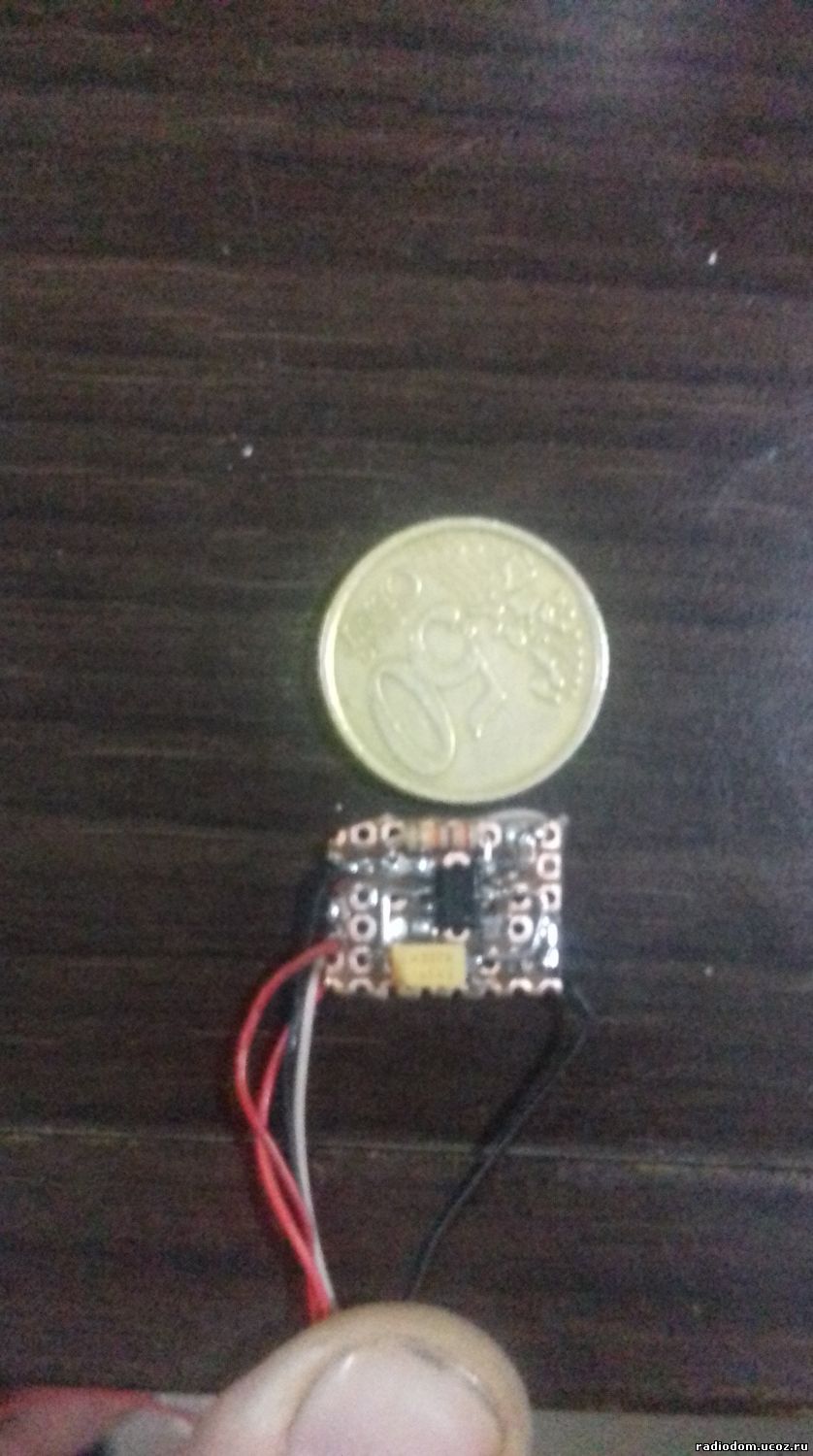

--Zenit--, i made small audio amp for speaker and how to connect it??
Сообщение отредактировал acikaa87x - Понедельник, 04.11.2019, 21:51

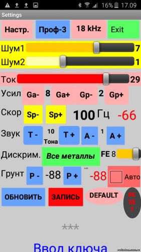

acikaa87x, You have a small current in Tx. You have to figure out why.Is there such a current at all frequencies? Should be around 100mA
Прикрепления: 3083403.png (197.8 Kb)

--Zenit--, on15khz is i think 90.  how to connect apm for speaker??
Прикрепления: 7660309.jpg (149.6 Kb)

+ amplifier to + BAT, - amplifier to GND, amplifier input to IN. The values of the resistors RF8 and RF9 are as in the diagram. If there is a weak sound, you can change their ratio

--Zenit--, is this better, on 15khz
Прикрепления: 5518607.png (209.3 Kb)

Пробуйте , может что и получится.  На плате ошибка где 100ом резисторы, надо резать дорожку и соединять ее с 7 ногой микросхемы. Просто сравните с новой редакцией платы. Плата под порезы вся, для опытов, то что не стесняйтесь.
