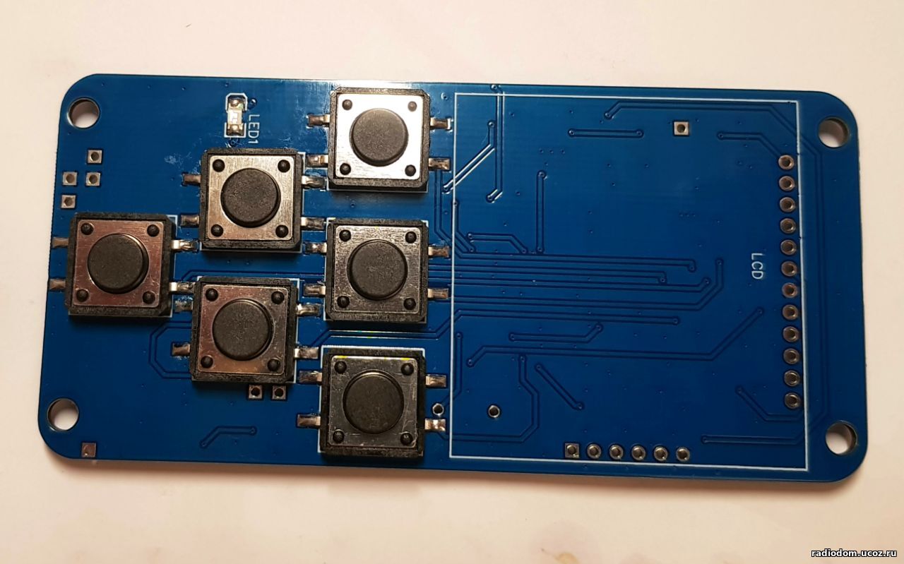

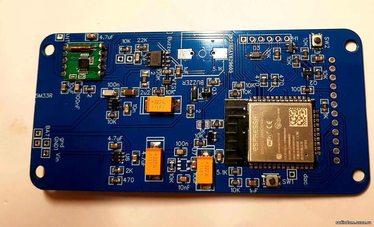

salah3Дата: Среда, 29.10.2025, 19:50 | Сообщение # 59
Сообщений: 35
Hello
Добавлено (09.11.2025, 05:35)
Hello friends
I assembled the board, please guide me to program it (what kind of program should I use and how to connect the program pins?)
Прикрепления: 3387873.jpg (166.8 Kb) · 7068322.jpg (109.0 Kb)
salah3Дата: Понедельник, 10.11.2025, 07:32 | Сообщение # 60
Сообщений: 35
I managed to program the board, but there is a problem. We have to hold the power button first and then press the reset button to turn it on. Please guide me.
