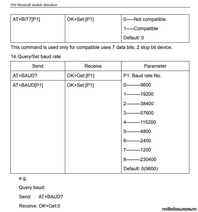

de-si-gnДата: Воскресенье, 21.01.2018, 21:40 | Сообщение # 271
Нашел даташит на HM-10, potashov прав - для 115200 нужна команда AT+BAUT4, переделал, но все равно приложение зависает при подключение блютуза
Прикрепления: 4014343.jpg (56.8 Kb) · HM-DataSheet_V2.pdf (846.0 Kb)

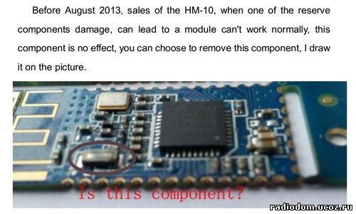

de-si-gn, More to read, little different.
Добавлено (26.01.2018, 01:14)
de-si-gn, Are you sure that you are using an HM-10 and not a copy like Bolutek CC-41A? I have also bought some BLE modules marketed as HM-10 on the ebay, but they turned out to be CC-41A.
https://forum.arduino.cc/index.php?topic=334466.0
""Although both modules look very similar, CC-41A requires that AT commands are terminated by LF+CR and there are differences in the command set. I am not sure if there are any other differences in the hardware, but I experienced that I cannot turn CC-41A into iBeacon mode or at least I cannot see it on my iPhone iBeacon scanner app after running the HM-10 iBeacon initialization sequence.""
If you try: AT+HELP  you'll get:

Прикрепления: Bluetooth40_en_.pdf (296.4 Kb) · 5739636.jpg (32.3 Kb)
