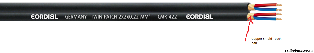

Hello ! I'm from Poland. Unfortunatelly Russian is not my speak language. But I see some post in english here. I was building krot-m, did not finish because of Krot2 :).  I have finished to build krot2 - I have finshed electronics - it seems to be working fine. I have problem with coil - to be more precise - with cable I think. I have used - http://www.hudebnicentrum.cz/eshop-cordial-cmk_422-11396.html - this cable - In previous posts It was recomended. But when I move a cable - my detector beeps - like at youtube presentation of bad cable sad
I have connected this way - two wires to TX, two wires to RX, shelds of each cable are connected together in coil and connected to coil sheild. In plug shields are connected together and connected to RX-ground. I have checked it by multimeter - seems to be all connected. But when I move a cable over a coil - Krot beeps. Where can be a problem?
And how to connect wires from pcb to plug in chassis ? now I have two concentric cables from S-vhs cable to a plug.

fedya_valkiДата: Понедельник, 03.08.2015, 11:11 | Сообщение # 687
Use S-VHS cable for you happy.
This cable have not a shield
Сообщение отредактировал fedya_valki - Понедельник, 03.08.2015, 11:13
piotrjadziaДата: Понедельник, 03.08.2015, 11:54 | Сообщение # 688
Сообщений: 3
Ok - on page 41 of this forum there is this cable - with recomendation "is good". This cable has two pairs of wires inside copper shield each pair. So I don't understand why ypu said - its not shielded.
Besides - SVHS cable which I have has two concentric cables (similiar as in TV antenna) and there is not main shield for this two pairs of concentric cables. And I was wandering if I have right cable and  how to connect it - because on schematics there is two pairs of wires for TX and RX, and shielding.
I understand, that my question is 100 question about the same on forum, but even at polish forum there is neverending discussion about the cable smile
fedya_valkiДата: Понедельник, 03.08.2015, 12:31 | Сообщение # 689
This cable have not cooper shield for each pairs of wire, as I understend which seen a photo from site: http://www.hudebnicentrum.cz/eshop-cordial-cmk_422-11396.html
piotrjadziaДата: Понедельник, 03.08.2015, 13:33 | Сообщение # 690
Сообщений: 3
You are wrong - there is copper shield around each pair - see my drawing smile
Прикрепления: 8908180.png (169.4 Kb)
